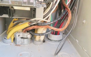

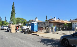

    On April 2-17 I was told that our department would accept the fact that unattended, exposed, energized metal presents an immediate life safety hazard. Four months and some days later I find it everywhere. I have had dozens in the last two months. Here is today:
    [​IMG]
    The contractor's employee was in a vehicle across the street. The equipment is in the backyard......with the little girl and her chicken.
    [​IMG]
    The worker was contrite, apologetic, defensive and just not someone that I would trust with electricity. He told me all about the inspectors that walk away from an inspection if the equipment isn't wide open. Those inspectors are us.
    A conservative estimate of the number of times that this has transpired in this jurisdiction over four months is 2000. Well for sure the number with little girls is hard to estimate and forget about counting chickens.
    #2365 ICE, Aug 4, 2017

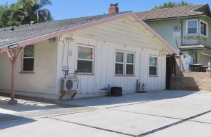

    A flipper created a laundry room without a dryer vent. I asked for a dryer vent. I also asked for a cap on the gas valve. This is their best effort.
    [​IMG]
    [​IMG]
    I've got to wonder what kind of fool that they think I am.
