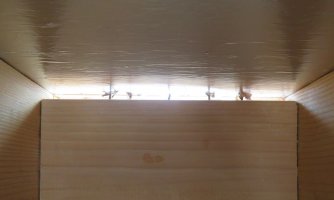

    This was the first inspection. The job is a bathroom under a patio cover associated with a swimming pool. The panel is not made to be embedded in plaster so I said no. I explained, several times, that a cabinet that fits between the studs or a cabinet that is installed after the stucco is the way to go.
    [​IMG]
    That's not what they heard. I gave the next inspection to another inspector. That inspector has been there before and did in fact, approve the rough electrical. I got a picture on my phone from that inspector because the contractor insists that I told him to do it this way.
    [​IMG]
    [​IMG]
    This was never mentioned. I explained the situation to two workers and then the hefe when he showed up. How they got this from what I told them escapes me.....I think that I am done explaining stuff to this bunch.

  17. my250r11
    my250r11 Sawhorse
    Joined:
    Feb 16, 2015
    Messages:
    339
    Likes Received:
    112
    Must rain from the ground up there.... lmao

  19. my250r11
    my250r11 Sawhorse
    Joined:
    Feb 16, 2015
    Messages:
    339
    Likes Received:
    112
    The first pic seems the trees are right, but their flashing, if you can call it that is wrong
  20. Pcinspector1
    Pcinspector1 Platinum Member
    Joined:
    Oct 28, 2009
    Messages:
    2,346
    Likes Received:
    213
    Instead of putting their name on it and the ASTM crap, they should put a picture on the tape showing how to install it!
    The tape doesn't have much stick-em for moisture protection.
