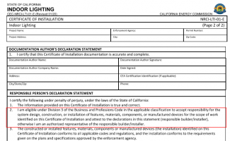

California lighting forms - who is eligible to accept responsibility?
Yikes
Gold Member
Nov 2, 2009
3,127
Southern California
CEC-NRCI-LTI-01-E references persons eligible under division 3 of the Business and Professions Code - see red box bloew.
Of course this code lists everyone from locksmiths to guide dogs.
Is there any published short list that summaries eligible professionals?
Division 3 is a catch-all for professional licensing.
So, contractors, Architects, Engineers and HEERs inspectors .....
