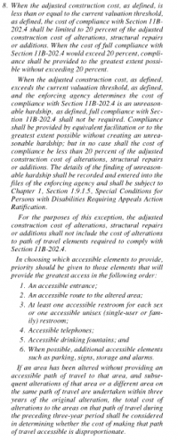

In CA 11B-202.4. When the adjusted construction cost, as defined, is less than or equal to the current valuation threshold, as defined, the cost of compliance with Section 11B-202.4 shall be limited to 20 percent of the adjusted construction cost of alterations, structural repairs or additions. When the cost of full compliance with Section 11B-202.4 would exceed 20 percent, compliance shall be provided to the greatest extent possible without exceeding 20 percent.
When the adjusted construction cost, as defined, exceeds the current valuation threshold, as defined, and the enforcing agency determines the cost of compliance with Section 11B-202.4 is an unreasonable hardship, as defined, full compliance with Section 11B-202.4 shall not be required.
Compliance shall be provided by equivalent facilitation or to the greatest extent possible without creating an unreasonable hardship; but in no case shall the cost of compliance be less than 20 percent of the adjusted construction cost of alterations, structural repairs or additions.
For the purposes of this exception, the adjusted construction cost of alterations, structural repairs or additions shall not include the cost of alterations to path of travel elements required to comply with Section 11B-202.4.

Mark, here's my question:
11B-202.4 defines the full extent of path-of-travel alterations as 5 items, and parking isn't one of them:
Q: If I have a $2 million interior tenant improvement project that will provide all 5 of these items, such that no declaration of "unreasonable hardship" is needed, then I don't need to utilize the 20% rule in 11B-202.4 exc. #8, right?
In that scenario, if I achieve all 5 items, and it cost me less than 20%, can the building official still compel me to provide additional accessibility beyond the 5 items listed above such as an accessible parking storage, and alarms, until I've spent 20%?
CA has a valuation threshold, currently $172,418. Once you exceed that value then full ADA compliance is expected, the 20% rule is out the window. You can still apply for a hardship exemption but that's a different story.

If the project is 2M, You shall fully comply with ALL code items, including those not on the list.
Joe and Mark, help me understand this for alterations.
11B-202.3 requires that each altered element comply with Division 2.
11B-202.4 additionally requires 5 "path of travel" components to be made accessible.
But beyond this where in the scoping requirements does it say that the entire facility ("ALL code items, including those not on the list") must be brought up to current code?

Check out CBC Chapter 1, Section 1.9, referenced in 11B-101.1
Also check out that link I posted earlier if you haven't already, specifically there's a link on that page that takes you here:
