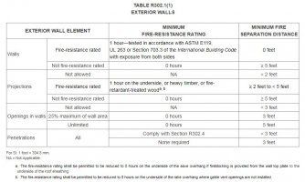

2018 Table R302.1
Francis Vineyard
Jan 1, 2010
3,105
Charlottesville, VA
So it now clarifies rake instead of eaves for the gable end wall, but what about the gable vent in accordance with footnote b?
Clarify the vent is permitted where openings are allowed within the FSD when the rake is of FRTW or 1-hr. rated construction on the underside?
Thanks in advance for your reply.
