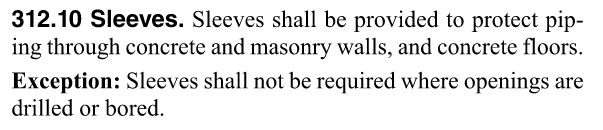

305.3 Pipes Through Foundation Walls
Any pipe that passes through a foundation wall shall be provided with a relieving arch, or a pipe sleeve pipe shall be built into the foundation wall. The sleeve shall be two pipe sizes greater than the pipe passing through the wall.
The purpose of the sleeve is to maintain an annular space around the pipe when the foundation wall is poured. IMHO it can be Styrofoam that you would remove when installing pipe.. If you core drill after the wall is poured you would not install a sleeve in the concrete wall.
I agree. The Iapmo code in 312.10 notes an exception, "sleeves shall not be required where openings are bored or drilled"
What should matter is the size of the hole and not whether a sleeve was provided.
