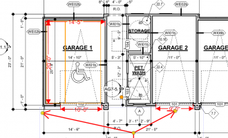

I have a group of private garage buildings, group U, with 6 to 8 spaces each, in an R2 development. They have OHD's only. Per IBC 1010.1.2 the MOE door is permitted to be other than a side hinged door, and as long as opening force is met, this is permitted.
For both accessible and non-accessible spaces, the MOE width is compromised once a vehicle is in place. So without all the details my questions is this:
Do the spaces get evaluated exclusive of the contents of the space? So provide operational constraints and reach ranges, and take the 9' or 10' width and call it a day? Sorry, this seems like such a nitpicky and obvious question....but if you give someone an accessible space to park, should they not have a minimum width to get out of the garage once they are parked? Or do we accept that if they want to park there, they better drive a little vehicle? The same goes for non-accessible, but I guess they could be expected to shimmy out a little easier.
They have provided the accessible spaces in these group U buildings, but I am not sure they are required to. The have also provided similar garage spaces under the buildings, but those are required per IBC 1106.2 #4. While those spaces do have a side hinged door, they would still be compromised by the parking of the vehicle.

The spaces do comply...inside the garage. It is the door opening that is 10'. So theoretically, someone can use the space, they just can't get out of it. Same with the space under the building. The spaces comply, and there is a man-door (can I still say "man"-door?), but it is in front of the parking space, so it could likely be rendered unusable in the presence of a car. These issues apply to normal MOE as well as accessible MOE. Best I can find would be as a corridor @ 36" or as an aisle @ 28", unless they are required to be accessible, then we are at 32". NONE of these things can be measured at the time of inspection because the obstruction isn't there, and would vary in size.

In Garage 1 can the OH door be moved to the left and a hinged door added on the side, back, or into the covered pasage?
In Garage-HC can either door be moved to the right side?
As this is plan review, yes they can reconfigure or add man-doors. But I want to make sure that I have a firm grasp of the requirements that would cause it. I try very hard to only enforce that which is written, and the intent if I can figure it out. For me, the real question is about the contents. Under most circumstances if I am not shown where a couch is, I don't worry about the fact that they could place it too close to a door so as to restrict a forward approach. However, these garages have a very strongly implied location for the vehicle, and there really is no option other than the size of the vehicle.
Shirley someone out there has experienced this????? There must be thousands of these buildings out there.
I have asked that all private garage accessible parking be provided with an ANSI ch.4 compliant door, accessible route and approach, and that it adjoin the access aisle per ANSI 502.4.1.
I am receiving some resistance to the requirement to add a door in these stand-alone garage units. They have pointed out and I have confirmed that the FHAG has guidance on the accessible parking in a private garage space. It requires the spaces to be 14'2" wide, with a min. 10' garage door. There is no requirement for a separate man-door. I assume the assumption is that the 10' width will allow sufficient space for access around the car. Neither ANSI nor the ADA have any guidance that I can find. Is following the FHAG for these accessible units parking spaces acceptable since the purpose statement for the ANSI standard states that the intent of ANSI is to be consistent with them. Or at least as a compliance alternative?

These are not wheelchair/van accessible spaces. They have a compliant space and access aisle, but I agree with the point. However since there is guidance from FHAG with specifics for this exact scenario I am trying to determine if that is equivalent. Since we have no idea what vehicle will be parked, can I arbitrarily assign a size, contrary to the FHAG specifics. It seems like FHAG has taken the "likely" scenario into account by requiring a minimum door width. Even if the door was 12' wide, we still can't guarantee the required accessible path since we can't control how the person parks. They could drive an F250, and squeeze as far over as possible and just make it, or they could drive a smart car and park too far to the opposite side and not fit. It seems that the FHAG has determined that a 10' door is reasonable.
