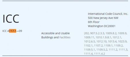

Okay thanks for your assessment. My questions remain, can the 67" wheelchair turning radius overlap the door swing still? Can it overlap the sink or only the toilet (not addressing the toilet flange issue right now)? The overlap identified in ANSI 117.1 now has this 'overlap' limitation. It used to be the overlap extended the entire diameter of the circle, but not now so I find this confusing.
2018 A117.1 document is not adopted by the IBC unless amended by your state to do such. Check out the CH. 35 Referenced Standards citation and you'll note that the 2009 version is still referenced.
