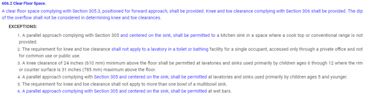

Work area exemption has been agreed to by most, but can you check out A117.1 Section 606.2 (below) regarding your second statement?
I think if you re-read Exception #1, you would want to revise your opinion on a side approach being possible.
As per the main statement of 606.2, forward approach is required. Exception #1 would only allow a side approach for a kitchen sink where a cook top is not provided. These are not kitchen sinks, therefore Exception #1 does not apply.
