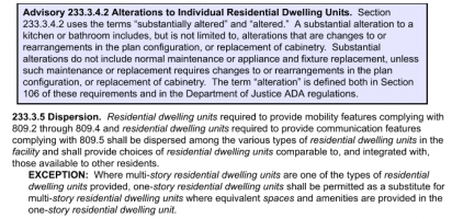

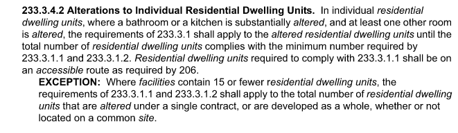

Some questions about a hotel project in Tennessee. It has 103 rooms, but only 5 ADA rooms (ADA requires 7 - 5 without roll-in showers, and 2 with roll-in showers). which are all on the first floor and in one wing. It will now be converted into an extended stay with the addition of a kitchenette and refrigerator. The new appliances will have the requisite clearances. The laundry area will also be expanded and will have the requisite clearances. The interiors may be changed. By and large, these are the alterations. They don't involve moving/constructing/demo-ing walls.
My questions are:
1. Will these alterations trigger the whole facility brought up to ADA compliance for A) Number of ADA rooms; B) Dispersion of the rooms across the facility by floor and room type; C) Provision of roll-in showers; D) Swimming pool access alterations
2. Does the entire facility need to comply with FHA? If so, do we need to look only at clearances as in Type A and Type B dwelling units (which may not be difficult with the clearances)?
Thanks in advance for your responses!

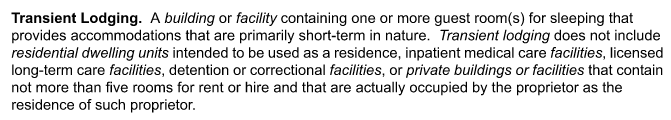

From 2010 ADAS:

Thanks for the question. The operator said today that there will not be a cap to the duration of stay, and has heard of another extended stay by the same brand where a person has lived for years! So I think this does qualify to be "residential dwelling units". I'll review it again from that viewpoint and come back with questions if any. Thanks so much for your input! Extended stays are tricky, lots of grey.

This may sound somewhat subjective, but the definition in ADA of transient lodging is accommodations that that are "primarily" "short-term" in nature.
  • "Primarily" means that there is the potential for 49.99% of guests to be long-term in nature (whatever that means).
  • "Short term" is not defined and is therefore open to subjective interpretation. In California, our state defines "short term" as "generally 30 days or less", but again the word "generally" allows for unspecified exceptions to the 30 day limit.
If you are the design professional, you can ask the operation if their intent is to provide "primarily short-term" accommodations, and get their response in writing to paste onto your plans.
