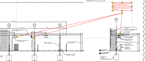

I have a fast food canopy over a drive through. It has gas heaters and electric fans installed at 8' above the drive surface under the canopy roof. There is no garage door, just an open canopy. They do show "removable magnetic delineators" to keep vehicles from passing underneath the appliances. Would you consider this "protection from vehicle impact"? What about a height restriction bar hanging over the entrance?

From the picture, those look like infrared radiant heaters. IFGC 303.4 (and IMC 303.4) requires protection from vehicle impact anywhere where vehicles can hit them, not just in garages. You don't want a truck hitting the heater and busting the gas line. No different than protecting an AC sitting in a parking lot.
Also, infrared heaters will have required clearances around them, including below and to the side. The clearances below can range anywhere from two to seven feet depending on the manufacturer's requirements. They usually specifically include vehicles in their clearance requirements. They can get surfaces below them hot very quickly, and can actually cause the paint on cars to bubble up if they are too close.
Going down another path is the building sprinklered? If so, the exception for noncombustible overhang omitting sprinklers does not apply if there are heating devices under the overhang
All good comments. CDA nailed it, that is the applicant. I think the section does apply. I don't think the proposed "magnetic removable delineators" would meet the condition that a vehicle couldn't pass under them. They don't show a head knocker, which I think is a more effective deterrent, though still not sure it would meet that standard. The canopy is separated from the building. I will need to consider the energy implications, frankly I didn't think about that, and am not too concerned. I will look more into the clearance requirements, as well as the sprinkler question. They also just revised the design to not include them.
Here is a snippet.
How high is the drive thru, clearance for vehicles??
Patios have heaters all the time!!
If the canopy is not connected to the building, no fire sprinkler protection required.
10'2" total height. 7'5 to the bottom of the fan, 8' to the bottom of the heater, per the drawings. My truck with the rack would take them both out if I didn't see the "delineator", or if they provided a head knocker and I ignored it. I also wonder how planning will take this, the lines at these places are already causing traffic back-ups.

I researched the heater and found a minimum clearance to combustibles is 9', also says 9' is minimum "recommended" for comfort. Diagrams show the minimum clearance to combustibles is the floor to ceiling distance, with no mention of clearance to objects sitting on the floor, such as a combustible table, car, or fast food worker.
