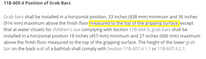

I would agree, however, the way CASP reviewers are interpreting here in California is that it is measured to the graspable surface of the grab bar. So we measure to the interior side, not the center.

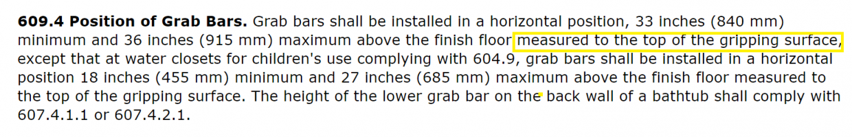

609.4 Position of Grab Bars.
609.4.1 General.
Grab bars shall be installed in a horizontal position, 33 inches (840 mm) minimum and 36 inches (915 mm) maximum above the floor measured to the top of the gripping surface or shall be installed as required by Items 1 through 3.
1. The lower grab bar on the back wall of a bathtub shall comply with Section 607.4.1.1 or 607.4.2.1.
2. Vertical grab bars shall comply with Sections 604.5.1, 607.4.1.2.2, 607.4.2.2, and 608.3.1.2.

Look at ANSI/117 Section 104.3 and there is a table explaining what each symbol in the drawings represent. The picture you posted is just giving you a "range" not a specific number

My original post was not referring to the vertical height measurement, but rather to the horizontal measurement. for example, when ADA says you need a 36" long grab bar at the back of a toilet, do you use measurement 1, 2, or 3 below?
I accept either. As long as the bar (and not just the flange) extends to 54" measured from the back wall. Just be sure that the bar is also within 12 inches of the back wall.
