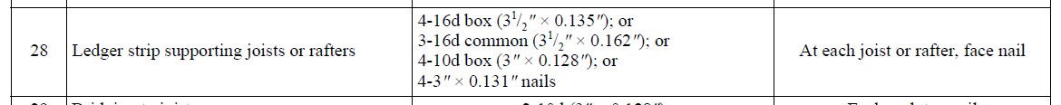

I am raising the floor in my 22'x25' garage. I will run a beam the 22' length to attach one side of the floor joists to. My main question is, can I safely attach the 2x10 ledger to the existing 2x4 wall to hang the other end of the floor joists from?
The main difficulty with the ledgerlok bolts going into 2x4s is that there is not a lot of width to the 2x4 you are going into. Ledger bolts don't usually fail by breaking, they fail because the wood around them fails. Not that it can't be done, but if I as an inspector saw you going with ledgerloks into 2x4s, I would tell you to have an engineer look at it before I would approve it.
The code calls out either 4 framing gun nails per stud, or 3 16d common nails per stud in Table R602.3(1), item 28. That may be cheaper than ledgerloks anyway, and that is probably the route I would take.

R502.6 Bearing. The ends of each joist, beam or girder shall
have not less than 11/2 inches (38 mm) of bearing on wood or
metal and not less than 3 inches (76 mm) on masonry or concrete
except where supported on a 1-inch by 4-inch (25 mm
by 102 mm) ribbon strip and nailed to the adjacent stud or by
the use of approved joist hangers.
Build a perimeter wall to support the ends of the joists and carry the loads, then attaching the ledger to the existing 2x4 studs will be just for lateral stability, not load bearing.
