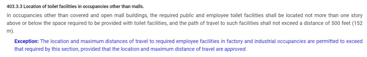

Our Department is embarking on the construction of sleeping quarters for our employees and were hoping to build generic standalone structures rather than the costly design of additions to existing buildings. This is being done due to Fire Marshall violations for current use rooms within our garage buildings.
Question: Are bathroom facilities required by building code in these separate stand-alone structures if the existing garage with bathroom facilities is less that 100 yards away, likely less than 100' away? We plan on all the required egresses, smoke alarms, etc but having to install a bathroom for a sleeping employee will be a deal breaker, especially when there is one only steps away.

Same site 500'?
[P] 2902.3.2 Location of toilet facilities in occupancies
other than malls. In occupancies other than covered and
open mall buildings, the required public and employee toilet
facilities shall be located not more than one story above
or below the space required to be provided with toilet
facilities, and the path of travel to such facilities shall not
exceed a distance of 500 feet (152 m).
