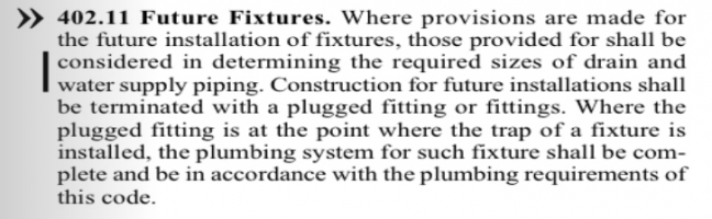

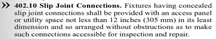

plan check correction says "provide a permanently accessible 12" square bathtub trap access or note that a non-slip joint trap will be used 402.11 CPC"
Ok, making more sense now. Plans examiner is slightly off on his/her reference and this has nothing to do with the trap, but instead the joints at the trap. If using a slip joint connection, then access to the slip joint is required. Easy answer, do not use a slip joint. IMHO - Any responsible plumber would hard-pipe this and would not use a slip joint. Slip joints are cheap and unreliable - do not use in a concealed location. That said, they are permitted by code and can be used at your own discretion.

Requirement for access has nothing to do with stoppages. Access is required because slip joints have hand set threaded fittings that are prone to leaking and will come apart if drain is snaked.
Thus, glued fittings are the proper way to go.
