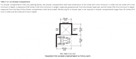

Can 36"x36" transfer showers in a Type B unit have a curb threshold that's larger than 1/2"?
Ryan Schultz
Apr 2, 2012
269
Madison, WI
We're under ANSI A117.1 2009.
Can a 36"x36" transfer shower in a Type B unit have a curb threshold that's larger than 1/2"?
That is because 117.1 is still not compliant with ADASAD minimums, isn't it about time that they do?
ADASAD 608.7 normally requires max 1/2" thresholds in transfer showers, but it has an exception that allows max. 2" thresholds at transfer showers only in existing facilities where a 1/2" threshold will "disturb the structural reinforcement of the floor slab".
