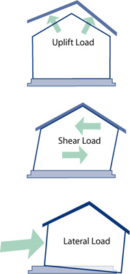

Good illustrations MH,
Steve is obviously not a DP? Why do balloons rise and kites fly?
They are not buildings, balloons only rise with hot air or filled with something lighter than..o_O.....Try running a building with no true walls through the IRC for wind and let me know how that works out. We were speaking of bracing, not uplift, but we have tables for uplift, so that is a non-issue and can easily be dealt with in the IRC.
Walls are the bigger "sail" which is what is shown in Marks 3rd picture...Without them there are significantly less reactions on a building...
But without Bender chiming back in, we may never know the specifics of his question...
Walls or no walls there is uplift when wind passes over a roof due to the upward suction being placed on the roof.
90
Figure 1. Engineers analyze the interactive effects of high winds on a building in terms of four types of building responses: (1) "uplift," the suction of wind on the roof; (2) "shear" or "racking," the tendency of rectangular building elements to deform into out-of-square parallelograms; (3) "sliding," a sideways pushing force; and (4) "overturning," lifting and toppling of the structure from the windward side. An engineered design has to provide for connections of predictable strength to resist all of these assumed load conditions.
Let's take a closer look at just one kind of loading: uplift. When a high wind strikes a house, the flow of air over the roof creates an upward suction, in the same way that wind creates lift on an airplane wing. Wind tries to lift shingles and sheathing off the roof, the roof sheathing pulls up on the roof rafters or trusses, the roof structure pulls up on the wall plates (trying to lift the walls), and the walls pull up on the floor deck or foundation that they rest on. If any connection anywhere along that load path fails, the structure can come apart. It's just one of the ways that wind can destroy a house, but it's an important one and has to be understood, designed for, and built for.
