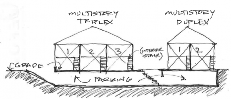

I have a client who wants us to design a small condo complex consisting of a common subterranean parking garage with a concrete deck at grade level.
On this podium, we will have two structures: one duplex and one triplex, with a open-air courtyard between them. All 5 units are multistory townhomes, and all are condominiums. There is currently no elevator planned for the site.
CBC 1102A and 1102A.3 says that (multistory) condos with 4 or more dwelling units per building are covered multifamily dwellings.
Question:
Because the two separate buildings (duplex and triplex) sit on top of a common podium over the subterranean parking garage, are they actually considered as a single structure, and thus are covered multifamily dwellings?
There is no above-grade structure that connects the two buildings; the only connection is the common parking garage below grade.
If hey are covered, 1102A.3.1 will require at least one town home to have its ground floor accessible (kitchen, powder room, etc.). More significantly, 1009A would require the parking for that unit to be accessible, so they'd need a lift or elevator down to the garage.

My scenario looks like this in longitudinal section:
Is the bottom floor that appears to be at grade, the first floor of the dwelling unit or is it empty and with dwelling starting on the second floor?
If the first floor is a part of the occupied dwelling unit then the first floor only would be required to comply with FHAG. If there is only a half bathroom on the ground floor (instead of a full bathroom) level then that half bathroom would need to comply with paragraph (a) of 7(2) of the FHAG. The second story level within the multistory triplex or multistory duplex with interior stair ways would not be covered by FHAG. Let me know if you need more information. Unfortunately I am am not familiar with CA laws on Multifamily units with more than 4 unit dwellings in each pod. I am assuming there are more than four units per building pod. If not then none are covered by the FHAG. It has to have more than four dwelling units in each building pod. FHAG looks at connected units such as duplex or triplexs with four or more dwelling units in that building.

The issue for this client relates to the parking. This project is on an extremely tight site, and if there is a CMD the project will shrink from a 5 units to 4 units, a 20% reduction in the size of the development.
Once one or more units becomes a CMD, then:
1. The underground parking needs to have a accessible stall, which will take away an 8'x18' space (we'll lose a zoning-code required parking stall).
2. The subterranean parking will then need an accessible path of travel - in this case, an elevator, LULA or wheelchair lift - from the accessible stall to the CMD. This will wipe out yet another parking stall, and it will also take away from zoning-code required open space at the ground level.
The site is so tight that the loss of even one stall will result in the loss of a dwelling unit.
I think developer bought the land based on an appraisal that indicated the site was zoned for 5 units. A CMD will make it almost impossible to get 5 units, and will make 4 units very expensive.
To recap, the problem is not making the multistory units 11A accessible, The problem is making the subterranean parking accessible for CMDs without killing the project. The workaround is to see if there's a way to avoid CMDs altogether.
I'm just seeing if CBC-11A and FHA considers the above-ground buildings separately even if they are sitting on top of a common underground parking garage.

Just to be clear:
By "that should do it", do you mean "yes" it is OK to consider the above-grade buildings separately, and a 2-unit building and a 3 unit-building sitting on top of a common subterranean parking garage will NOT trigger FHA "covered multifamily dwellings" and therefore I conclude that there will be no accessible resident parking required by FHA of CBC 11A.
Is this correct?
That is my understanding. Any multifamily projects with under 4 dwelling units are not considered FHA covered units.
