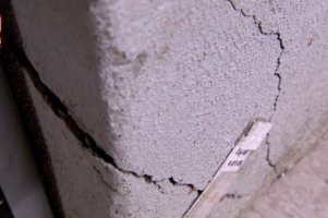

Meanwhile, new photos show cracks have opened up in the ceiling and between the wall and baseboards of Unit 36B.
Experts fear those cracks could be more evidence that an entire 58-story stack of windows may be coming apart from the building. That’s a threat city officials hope Millennium will take seriously.

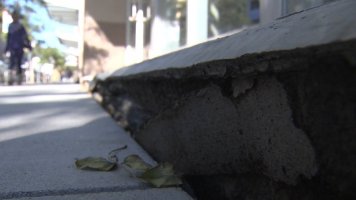

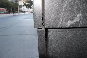

The city's concerns appear to be primary based on the risk of the falling glass injuring pedestrians.
The pictures Mark Handler posted appear to be at the base of the building. Given the magnitude of the settlement I would expect to see this sort of damage but this is not an indication that the building is unsafe.
The building has settled but the adjacent ground not so much. Thus you would expect the local distress.
