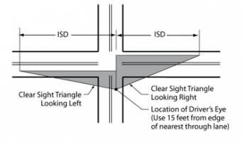

Here is a visual representation of a vison triangle.

Anytime you are interpreting a requirement, you have to keep in mind the intent. Presumable, you are concerned about the motorist's line of sight and as others have pointed out, you would take the measurement from where the motorist is impacted at.
In San Diego the visibility triangle dims are along the property line and this should be documented in your municipal code.
When this conversation came up here the explanation that was given by the decision makers was that in some places the property line and the ROW were at the same point, back of sidewalk. In other areas the property line is at the transition from sidewalk to street, and in other places the property line is actually out in the street. The decision was made to use the ROW line as the measuring point so that all were treated equally. I drive around the city a lot and in the areas that are previously non-compliant are definitely more difficult to see in most cases. On the flip side even in places where the "proper" vision clearance was maintained, there are often other obstructions such as parked vehicles.
