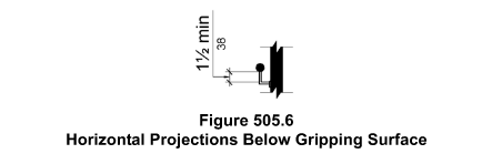

tbz, the key requirements for max. 4.5" projections are found in IBC 1014.8:
"Projections into the required width at stairs shall not exceed 4 1/2" at or below the handrail height. Projections into the required width shall not be limited above the minimum headroom height required in section 1011.3."
So in theory, a straightforward reading of this allow walls BELOW the stair handrails to project inward 4.5" on either side, making the tread width on a 44" wide MOE only 35" (for handrails at ramps, the minimum is 36").
Your detail generally appears to work and is an elegant solution. One nitpick: you show the clearance below the handrail (red dotted line) as radiused. I don't think ADAS 505.6 recognizes a radius for its 1.5" clearance, so you may want to double-check that with a second "ADA" dotted line, especially if there are 4" o/c horizontal guardrail members going between the posts:

I get all the sections and protruding objects, but what you are forgetting is that the handrail clearance beneath the handrail is allowed to be reduced .125" per every 1/2" of perimeter the handrail is over 4".
Thus, with a 1.5" diameter handrail you have a permitter of 4.7" aprx, thus you only need to be 1.375" down beneath the handrail, not 1.5", and when you do a 2.25" offset from the edge of a 1.5" diameter handrail, hence the radius, it passes the line 1.5" horizontal over and 1.375" down from bottom 1/10,000 over the required square off.
Something only those of us in the detailing world that draw it everyday, know, its a habit to create clearance area when I draw.
If I was doing the 2.25" full clear you are correct the offset is further down for 2.25 over and 1.375" down, I was just trying to point out were the 44" is measured between above the handrails, not the actual tread edge.
and I was showing the full inward projection of 4.5" with the vertical mark out below.
was not really trying to show full clear.
