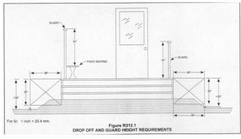

Please render your opinion if this raised concrete balcony is compliant with 2016 CRC and CBC 312.1.1.
312.1.1:
Guards shall be provided for those portions of open-sided walking surfaces, including stairs, ramps and landings, that are located more than 30 inches measured vertically to the floor or grade below at any point within 36 inches horizontally to edge of open side.
312.1.2:
Required guards at open-sided walking surfaces, including stairs, balconies or landings, shall be not less than 42 inches in height as measured vertically above adjacent walking surface or the line connecting the nosings.
Raised concrete balcony
-18” tall boundary wall on balcony.
-51” from top of boundary wall to top of planter box.
-70” from top of boundary wall to concrete driveway and to bottom of empty planter.
-Planter box width 30” from edge of open side
you are mixing the commercial code and the 1 & 2 family code,
You are under the 1 & 2 family code your guard needs to be 36 inches tall and depending on the edition you are under the hight above the fixed seats changes s
Commish: Yes, you’re right, this is single family residential so CRC would apply. I only placed IRC diagram for reference of code intent. The height requirement for guardrail for CRC would be 42”. My question to everyone is, please tell me if it is compliant with CRC and if so/not explain.

No your proposal does not meet the code, without additional rails or other barrier.

No your proposal does not meet the code, without additional rails.
Thank you, Mark Handler. I appreciate your input.
