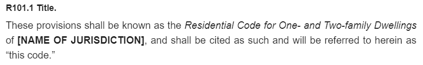

Just wondering for my info
What section of IRC or IBC is that from, the bump?
Depending on your State or AHJ's interpretation of or charging language, the OP description may be construed to be 2 multi-family structures.(apartments) which will be out of the scope for the IRC
