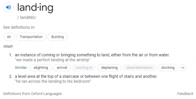

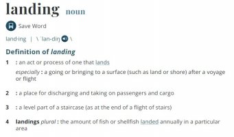

Before I replied, I checked Google. The result is in the attachment. I also attached the result from Merriam-Webster, which says it's the level part of a staircase.

Thanks, SH :) Trust me, you don't have to convince me about the "common" definition - I have to convince him of a "code" definition.
