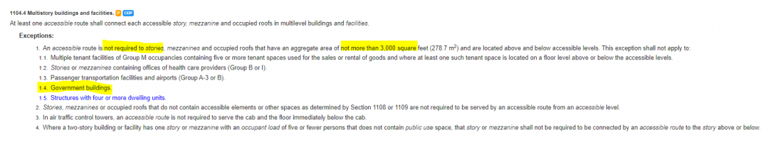

I have a similar project: 2-story 8,000 SF per story, New construction, government building of B occupancy, sprinklered. The government explicitly said no elevator would be required, but to the contrary I found this section in the 2021 IBC: 1674232261478.png
I think he's misinterpreting the double negative in the IBC exemptions.
Title II of the ADA still requires federal, state, & local government buildings to meet ADA Standards for Accessible Design. I can't find an elevator exemption under the Title II standards.
Yes - There is an exemption to the exemption for Government Buildings. LOL. I just wanted to make sure I was reading that correctly since the gov't. was so sure there would not be an elevator or assessible route to other stories. And the fact the each story is 8,000 sf definitely confirms the need for an elevator.
