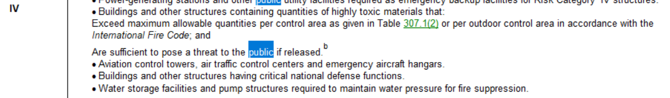

@mtlogcabin, I'm not familiar with what the implications are there. The building will be a pre-engineered metal building, and the structural design will be done by a structural engineer. Are there other implications I should be aware of?
I'm not sure which bullet point you're referring to that would kick us into Risk Category IV, but I'm assuming it's either the "power-generating stations" line or the "highly toxic materials" line. While it is an emergency backup facility for wells related to wastewater treatment, I don't believe wastewater facilities are themselves considered a Risk Category IV structure. I also don't believe diesel would fall under the definition of a 'highly toxic' substance. What am I overlooking?

I agree it would not apply for a wastewater facilities. I was thinking private water purveyor providing potable water (cat III) for a subdivision which is quite common in a rural areas in this state or cat IV for fire suppression systems in rural areas without a public water source.

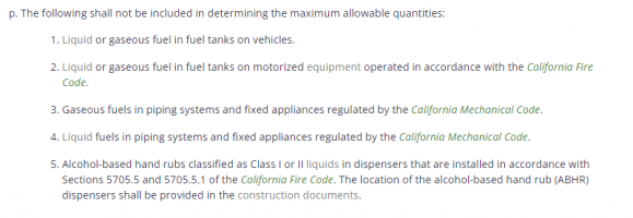

Ah ok, gotcha. Any ideas on occupancy classification? In CBC Table 307.1(1) footnote p, Items 2 and 4 both appear to exempt me from needing to stay below the max quantities listed, as the diesel being stored is in service to 'motorized equipment' and/or a 'fixed appliance' (a generator):
The column in Table 307.1(1) where H-2 or H-3 is indicated actually states, "Group When The Maximum Allowable Quantity is Exceeded". Interestingly, per footnote p, I am not exceeding the quantities of the table. Does that mean it is not an H-2 or H-3 occupancy? And if not, what is it?? I would lean toward a U Occupancy. Would this be up to the AHJ to make a determination on?

What type of fuel will the generator use,
...fuel oil or diesel ?......If diesel, then, IMO,
the Occ. Type will be a "U".......An enclosed
generator, transfer switch & other telemetry
equipt. would not fit the description of an
H Occ. Group........Also, no separation of
the electrical switch and the generator,
or sprinkling of the structure would be
required......Essentially, you will have an
un-habitable structure with power
generation and distribution equipment and
a 1,000 gal. Belly Tank........The generator
exhausts will exit the enclosure thru the
exhaust pipe to the atmosphere.

I agree that it does not fit the definition of other occupancies, so it meets the definition of a U occupancy, which includes "miscellaneous structures not classified in any specific occupancy".
With a metal building, you are Construction Type II-B, which will probably work for most any other potential occupancy classification anyway (S, F, H...).
My suggestion is to submit for plan check listing it as a Type U occupancy on your title sheet of plans, and then if the building official wants to call it something else, it's a simple clerical backcheck correction.
