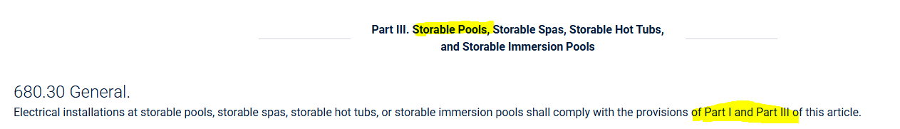

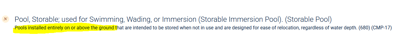

On the upside, I think I heard that they were going to move away from this for on/ aboveground pools with a definition change or being considered storable...

I'm glad they will exclude storables though.
