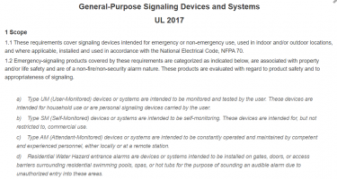

Code allows an equivalent way to guard the pool area besides the listed UL2017 pool alarm. How do I know if the pool alarm is equivalent just because of what it says on the cover of this pool alarm. I don't know what UL requires in the electronics, sound, etc. in an alarm and would not know what to check for. Would you approve this pool alarm?

Maybe it's a bad assumption, but a quick check of UL 2017 seems to indicate that there are different categories of products covered by the listing. So I don't know off the top of my head whether this particular product is intended for the proposed use. Based on what I know right now (admittedly not much) I would simply want to see the MFR specifications to see if it is covered under the correct category. I don't know if a door security alarm can serve as a life-safety device so unless the MFR specifications says it is I would want to make sure. As an example, I received a submittal for a water surface alarm as a pool barrier a few days ago, the submittal document says it meets ASTM F2208. I have enough knowledge of these devices to dig a little deeper. The product does meet that standard, but that standard does not cover the product for use as a pool barrier. If the MFR data of the device in the OP clearly says it is listed as a pool barrier or life-safety device then I have done my due diligence, if not, the question would be why. I'm just saying it may not be enough to just stop at the UL tag, especially for a device of a critical nature. As always, I could be wrong.
I don't have the full text of UL 2017, and I can't be sure the scope above means that all UL 2017 devices can be used as a residential water hazard entrance alarm, or only those shown to be in that category are.

The picture in the OP doesn't say what it is, just a picture of a device with a UL number. If that was submitted to me I would ask for the MFR specifications and make sure it is listed and labeled as a "water hazard entrance alarm", which is what ISPSC 305.4 #1 says it must be. It probably is, and should be very easy to demonstrate with installation instructions. The bar isn't that high for me on these codes, but since it is specifically called out in the code and my name gets attached to it, I figure the least I can do is make sure it is what they say it is. I am not questioning the fact that it complies with UL 2017, only that I don't know what that listing covers. Your code reference says "exit alarm", mine says "water hazard entrance alarm". Maybe this demonstrates that there is a difference?? Or not, but for me the installation instructions are a requirement, and they would probably tell the tale. In your neck of the woods you have way more pools, and I am sure way more expertise in them, so maybe you are way more familiar with them than me, but without that familiarity, I am going to ask for a little more.

The website that Jeff provided lists the authorized NRTLs. If you click on the more button associated with each NRTL it takes you to a list of all the standards that the particular NRTL can evaluate products to. ETL is allowed to evaluate products to UL 2017.
Any NRTL that has that standard on thier list can evaluate and list the product.
I can say that not all NRTLs are equal in their evaluations. However it is an onerous task indeed to challenge a listing.
