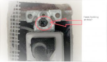

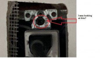

Mark, I think your correct, that appears to be a drywall screw in the plate mounting hole.
Over cut drywall can be cited.
A lot of appliances don't even come with cords. Always crying between electrician, contractor/home owner who is responsible to supply. You know....That was not in my bid.....should be....only the receptacle....etc.
I believe the manu. on these thinks it is cheaper for them and then end user can hard wire or use the cord they want or match what they already have.
I think its what is called a drywall framing screw, not the typical screw that is used to attach the drywall to the studs. The framers are about 1/4” long, just enough to connect two studs. They dont have bugle heads like typical drywall screws.
