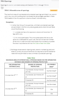

Working on a Type IA construction residential project with a sprinkler system. If the entrance door is at the property line does it need to have a fire rating?

You cannot have an opening within 3-ft regardless of construction type.

Wait.... is this per the IRC or IBC?
I see now that you note residential, but you also called out Type IA construction.
Although, it will not matter much, as per IRC Table 302.1(1) openings within 3-ft are not permitted either.

If I keep walking straight,,,,, where does that take me??
Middle of the street??
Or how far till I hit another building?
Can you explain that. If the exterior building wall is on the prop line ... no doors allowed?
Ok... a bit more of the picture now. If it is facing a public way or street, read through the following code section. If it is 3-ft to a property line where the adjoining parcel may be built upon, see the Table (cropped to only include 0-3 and 3-5).
