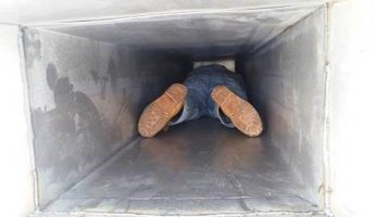

Ground based HVAC unit for a gymnasium. Plans called for exterior duct insulation and protective wrap. Contractor and engineer now saying the R-4 interior insulation on this duct is sufficient. R-8 is required (2009 ECC adopted), but I'm also concerned about the insulation being on the inside of the duct, rather than the outside. Seems to me that condensation and mold is a likely problem in the future. Would appreciate thoughts on this one - we just recently began enforcing the ECC.

For what it's worth, I don't know why anyone would ever insulate on the inside of a duct. As you mentioned, there is an increase in the likelihood that it will be conducive to mold growth, but it also introduces potential contaminants in the air stream through both material off-gassing and particles such as fiberglass, which are known respiratory irritants. Additionally, it completely screws up your friction calculations for your ductwork, you now have to buy larger, more expensive ductwork to deal with the reduction in area of the duct and friction loss. The only advantage I can think of is that the insulation is protected from damage.
The insulation is on the inside to protect it from the elements.

604.13 Internal insulation.
Materials used as internal insulation and exposed to the airstream in ducts shall be shown to be durable when tested in accordance with UL 181. Exposed internal insulation that is not impermeable to water shall not be used to line ducts or plenums from the exit of a cooling coil to the downstream end of the drain pan.
Needs to be R-8 minimum

Internal duct insulation used to be used a lot for sound reduction, and still is to a limited extent, mostly when very low noise levels are needed.
