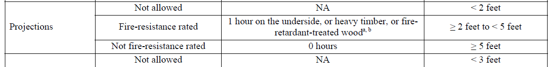

The owner would like to build a roof deck on his 3-story Single-Family Attached Dwelling Unit (A typical Philadelphia rowhouse). There is currently no roof access structure, and he had the thought to expand one window to allow a doorway that would open to an exterior landing/stairway made of essentially fire escape construction that would lead to a newly constructed roof deck.
I looked in Chapter 3 of IRC 2018, and there didn't seem to be anything that would expressly prohibit this, but I was wondering if I'm missing something.
Thank you for your help!
We're thinking it would be on the side of the house, overhanging the "side yard" (maybe <=5' from the shared lot line) and passes by at least one window.

Not likely to be allowed. That which would be allowed would be designed by an engineer. Planting a staircase on the side of a building from the third floor to the roof would be an expensive bit of construction. That’s not to say that it could not be done with enough determination and money.

The Philadelphia Code recognizes the legal, continuing use of EXISTING Fire Escapes which historically are more about Ladder Geometry and Not Stair Geometry.
The Philly Code follows the ICC Bldg Code for new construction, and therefore does not allow New Fire Escapes.
In addition think of the safety of the guard rail heights and having civilians use a ladder cantilevered off the side of a 3 story building exiting, what was a window.
It makes more sense to build the Roof Access Structure and keep people safe
