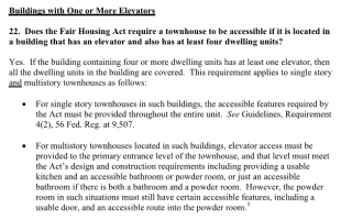

FHA says that when you have a new building that has an elevator, 100% of units are covered multifamily dwellings - - even the only townhome on the project!

From the HUD / DOJ joint letter:
My specific design problem is that the townhome's primary entrance level is sized almost like a carriage unit* - - just enough room for the entry door, stairs, and a nice entry closet; but not big enough for the powder room + kitchen. Therefore I need to change the entry closet into a private residential elevator shaft.
