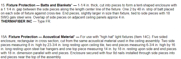

We still have a building that we work in that has a 1 hour rated floor ceiling assembly that uses the lay in tiles as a part of the assembly and the lights protected with gyp board boxes. It is terrible.
