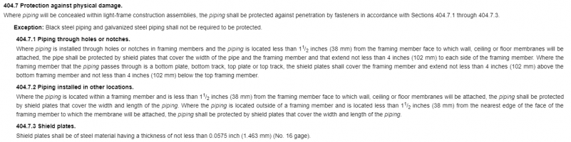

What would be the code violation for a flex gas line running from a gas manifold in a residential attic going to an outdoor grill through an eave that is touching roof deck?

I ask that the CSST be 18 away from a roof deck. The concern is that a fireman with a chainsaw can hit the pipe. A few years ago I was challenged by a contractor that ran the CSST attached to the side of a rafter. The pipe was a couple inches from the sheathing. As I recall there is no code provision for that nor was it addressed in the installation instructions.
The installation instructions may have changed.....but nope, I just took a quick look and Gastite hasn't added anything about the tubing and a roof deck.

From the 2015 IFGC -
For the OP's situation, 404.7.2 would apply - a minimum of 1-1/2-inches is required from pipe to interior face of sheathing, or one must protect the entire section of affected pipe w/ 16-gage steel plate.

Counterstrike....for example:
NOTICE: Only CSA approved hardened striker plates listed for CSST systems may be used. a. At support points and points of penetration less than 2 inches away from any edge of a stud, joist, plate, etc. shielding is required at the area of support and within 5 inches of each side (if appropriate). Use a half striker or a full striker plate in these locations. Figure: 4-19.
b. At support points and points of penetration 2 to 3 inches from any edge of stud, joist plate, etc. shielding is required throughout area of support. Use a quarter striker plate in these locations. Figure: 4-8.
R106.1.2 Manufacturer’s installation instructions.
Manufacturer’s installation instructions, as required by
this code, shall be available on the job site at the time of
inspection.
M1301.3 Installation of materials. Materials shall be
installed in strict accordance with the standards under which
the materials are accepted and approved. In the absence of
such installation procedures, the manufacturer’s instructions
shall be followed. Where the requirements of referenced standards
or manufacturer’s instructions do not conform to minimum
provisions of this code, the provisions of this code shall
apply.
