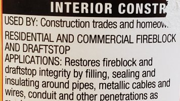

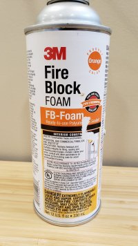

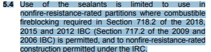

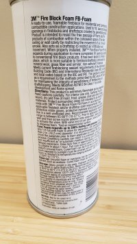

Fireblock in a can. This foam will not support a flame but it vaporizes when exposed to a flame. I tried to disallow it when used at wall plate penetrations and I was stopped because it is a listed fireblock material. In other words, they paid a lot of money for a listing.
3M FIRE BLOCK FOAM - We have to read the fine print... in small print at the back of the can.

Don't forget to check the caulking products also
3 M FIRE BLOCK CAULKING says the same thing.
3M Fire Block Sealant FB 136 is a one component, non-combustible draft, smoke and fireblocking sealant, designed to resist high temperatures and smoke passage in nonrated construction. Use 3M Fire Block Sealant FB 136 to seal interior construction voids around wires, pipes, HVAC ducts and vents, in wood or steel framed non-rated construction.
3M™ Fire Block FB 136 as a durable fireblock and draftstop. This product seals, fills, insulates and bonds for non-rated residential and commercial construction.
Will not sag or run in vertical or overhead applications
Reliable and Tough Fireblock
We engineered 3M™ Fire Block FB 136 as a durable fireblock and draftstop. This product seals, fills, insulates and bonds for non-rated residential and commercial construction. Ready-to-use, this fireblock is intended to resist the free passage of flame and by-products of combustion within a concealed space of a floor, ceiling or wall cavity, restricting the movement of air, fire and smoke. This fireblock is tested as a Type V commercial and residential fireblock to ASTM E 84 (modified) and acts as a draftstop to help reduce air infiltration. This ready-to-use product is heat-resistant (up to 240°F/115°C).
