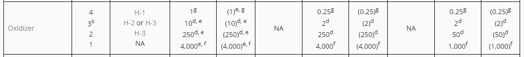

2012 IBC. I have a client that is building a water treatment plant. This is being constructed in an area where they don't have easy assess to a fire line to install a sprinkler system. It's an 8000 square foot facility with and enclosed chemical room that would store up to 400 gallons of 20% diluted Sodium Permanganate. Sodium Permanganate is considered a Class 2 Oxidizer per the Fire Code. If I use Table 307.1(1) my limits for Sodium Permanganate is 250 lbs. It is stored in a exhausted enclosure so I can increase that to 500 lbs which is only like 60 Gallons of chemical.
These seem limiting as it's a non-flammable liquid and we have it stored in a 3-hour enclosure.
My question is; I'm I calculating this correctly? Even if I could sprinkler the building I only can store 120 gallons max.

The limitation is the quantity per control area. You can have up to four control areas. If the hazardous material can be stored in multiple control areas separated by fire barriers per Section 414.2.4, then the building can be classified as a Group F-1. If you cannot divide the material into smaller quantities per control area, then the building will need to be classified as a Group H-3 (or at least that portion of the building).
As indicated by Ron, the alternative to the permissible (4) control areas is classification as an H-3 use. The trip there is that all H uses shall have fire suppression.

Table 307.1(1)

If the entire building is classified as Group H-3 (assuming you're using either the nonseparated occupancies method or the entire building is used for hazardous material handling), then the entire building needs to be sprinklered. If only a portion of the building is used for the Group H-3 and the remainder of the building is classified as to its use with a fire barrier to separate the occupancies per Table 508.4, then only the Group H-3 needs to be sprinklered.
