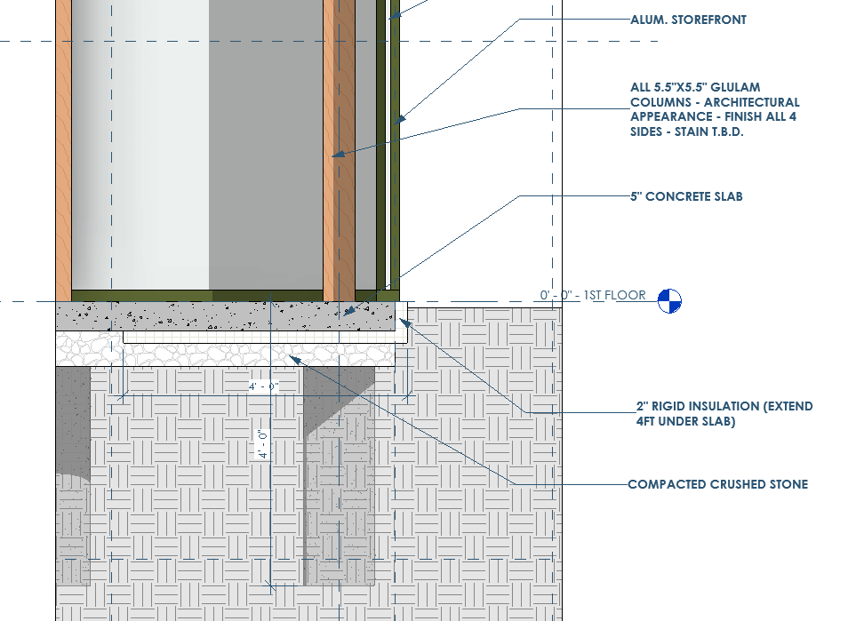

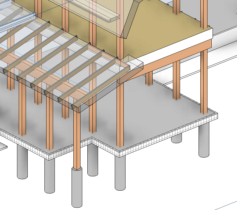

Per the following quote from C402.2.5, it appears that we can wrap the insulation under the slab as illustrated in the images below.
"or downward to at least the bottom of the slab and then horizontally to the interior or exterior for the total distance shown in the table."
In this condition, do we need to be worried about the slab heaving? This project is in a zone 6 (Wisconsin). If so, why is this condition allowed in the code?
Would just like to get additional opinions. Thank You.

Where do you think the slab would heave? I don't see an issue with the design or the IBC requirements, but, then again, I'm not from that region and don't have a lot of experience in extremely cold climates.
The insulation required in the energy code section is not for frost protection of foundation - it is to limit the amount of heat loss thru the slab. Frost protection for the structure would have to be provided by a different method unless the code specifically does not require frost protection for this structure (self supporting deck, detached accessory structure of limited size)
You can use engineered soils to prevent ice lensing, or use skirt insulation to protect the area under the slab.
I think the problem you have with the code requirement is that the code requirement is based on the presence of a foundation wall and footing. Since you have neither, maybe a reinforced thickened edge may counter any upheaval.
R403.3 will give you the prescriptive requirements for insulation for a shallow frost protected foundation
