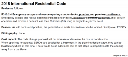

fatboy, I like your proposal, are there any other terms or situations other than a cantilever, deck or porch that we can think of or a term that means the same thing? (soffit or overhang?) I think cantilever covers most issues meeting that criteria.
Nice work and supportive of your effort!
Also the process, is this proposed change on a form provided by the ICC or is it required to be? Do you actually have to go to the hearing and present the change?
Maybe jpranch can shadow your proposal and help us all with the process, we might all learn something?
I think cantilever would be the best word because it would cover any cantilever, so soffits and other overhangs would be included as well. The only thing that would not be included would be things that are supported, like decks.
I agree, cantilever fits the bill, just wanted to make sure some smart guy doesn't say a cantilever's an a soffit are to different animals?
And that were thinking of other obstructions that prevent you from exiting?
What about an addition or a sunroom that was built on piers over a ERRO? A deck, porch and cantilever would not cover that.
I don't like using the word porch since it is not defined in the code.
Thanks all, I have amended it locally since the 2006 cycle, finally this cycle decided to try it in a code change.
Yes, you have to put the proposed change in through cdpAccess.
You HAVE to be there, but it helps if you go and pitch your own, a couple cycles back I had a change that I wanted to bring the language over from the IBC for opposed rafters at the ridge. American Wood Council said they would oppose it unless I agreed to the 1 1/2" max offset, so we co-authored a floor modification, so that's why you see that language now. If I would not have been there, might not have got what I got.
I'll let you all know what happens.
