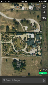

IRC or IBC???
cda
Sawhorse 123
Oct 19, 2009
20,963
Basement
Aaaaaaas
IRC. It's a single-family home. He just has lots of toys and a couple buildings to play with them in.
