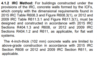

I think this detail above is what the OP meant, where they used ICF for the basement wall, and then they made the framing on top flush with the foam on the outside of the forms so that siding can cover both the framing and ICF in the same plane. I think the thickness of the concrete is not what is in question, it is the amount of bearing the bottom plate has on the concrete that is in question.
Being an inspector, and confronted with the idea of the front half of a wall bearing on insulating foam... yeah, I'm gonna make you get an engineer. The only saving grace is that you used 2x6s, so an engineer might be able to make it work.
To meet prescriptive code, you have to be fully bearing and keep your anchor bolts in the center 1/3 of the bottom plate - otherwise you will need an engineer.

Most ICF forms have a taper block to use on the top course. it only has 1" of Styrofoam at the top so only 1/2' or less hang over the foam
View attachment 8822View attachment 8823
Thank You
This is really interesting
Notice the rim board location in relation to the 2x6 plate
Like Joe L's example, it is also somewhat cantilevered over the 2 inch foam!
The rebar schedule and the flared top seems to make a lot of sense.
I wonder about the thin (3.5 in ) of concrete and wonder if the insulation will reduce the moisture that may, over time, rust the rebar, because of low / thin concrete coverage. Probably using 1/2 stone or a really small aggregate mix. I don't see the PSI of req'd. mix spec'd.
Given the "Non Traditional" design, I wonder if the Code Official will ask you to get an Engineer's stamp to validate. For good reason the AHJ may feel that they are sticking their neck, or some other piece of anatomy, out to be cut off later.
