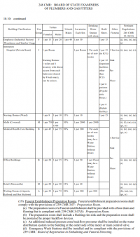

Am I missing something?
It seems as though Massachusetts does not have any language in the code specifying the minimum required number of plumbing fixtures. Per my understanding, typically this information is covered in Chapter 29, with the table showing each fixture count per occupancy classification. It looks like it may have been amended? Can anyone direct me to the correct place to find this information.
10.00 Uniform State Plumbing Code

    2. All buildings and structures other than residential dwellings that are intended for occupancy shall be equipped with sufficient sanitary facilities as outlined in 248 CMR 10.00.

Also keep i mind that MA does not use the chapter 10 egress occupant load to determining plumbing fixture counts. You need to establish an agreed upon occupant load with the AHJ based on more a realistic actual occupant load of the building. If you use the chapter 10 egress occupant load with the MA plumbing calculations you will end up with A LOT of toilet rooms!!! Personally I have found that using the IPC plumbing calculations with the chapter 10 egress occupant load is a good starting point early in the project and is usually in the ball park of the counts you get using the actually occupant load (as signed off by the AHJ) and MA plumbing code calculations.
