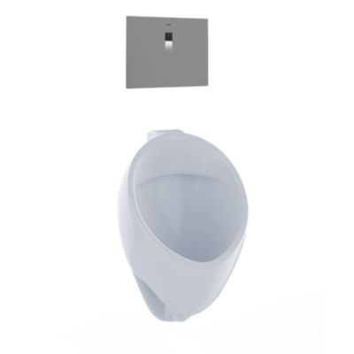

    From my experience, stall type urinals seem to get even more urine deposited on the floor. I'm not sure if this is because of where such urinals are typically encountered (bars and gas stations), or if it's again a behavioral issue (perhaps men stand farther from them and try shooting at the drain in the floor, rather than at the back wall). In any case, our restroom will be very low traffic, so I don't expect it to ever get too messy or require stall type urinals. Although that first photo NorthStar posted is like a work of art. And that copper Wye fitting is amazing. All that polished copper piping reminds me of my Navy days.
    This is the urinal I've selected for installing in our restroom:
    [​IMG]
