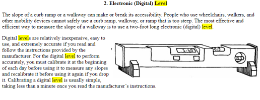

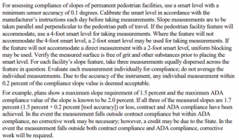

When measuring surfaces for cross slope and running slopes is there any requirement to use a specific length level? I get reports from people using 2' levels and the slope issues are everywhere. people using 4' levels and the slope problems are reduced considerably. Using a 8' level and the slope issues are again reduced. I typically use a 4' smart level. When I use the 2' level I can pretty much get it to read what I want with small relocations of the level. Seems like a specific length level should be required.
Is there any standard for this?

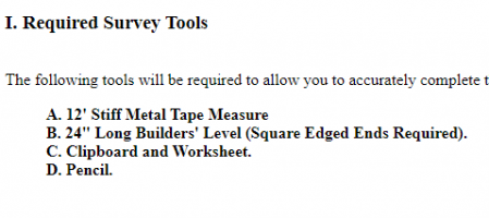

The DOJ uses a 2'-0" level which is why you should too. You want to recreate what you will be reviewed on and not waste money having to argue why a 4'-0" level should be used.

Here's a write up from the Access Board from 2011. It's not a standard but more of a recommended procedure: https://www.access-board.gov/research/building/dimensional-tolerances/ I know John Torkelson with theACCESSpartnership has a great write-up / seminar on how to take measurements and why. All of the DOJ/HUD photo reports I've read show them using a 2'-0" level also. I've seen drive-by litigators photo reports that use a 6" level which is ridiculous.
