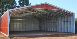

My example, that I got my hand slapped on:::
This is kind of my point though.... For the photo example, where do you measure to?
Is it the entire area under the projection of the roof? If so, then your including the area of the "walls".
If you measure to the inside face of wall, what happens if it is not a solid wall as pictured? Or walls on (3) sides that get measured to interior face, but where a wall is not provided, you must measure to the outward projection of the roof? Think about it... why would you increase the fire area (penalty possible) for removing a wall?

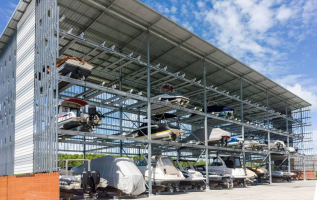

My other hand slap example, but no overhang on the front end:::
An exterior wall and an exterior wall envelope are not necessarily one and the same.
Is the enclosure around the boat storage an exterior wall? Yes, by IBC definition, since it is an enclosing wall that is bearing or nonbearing (looks to be nonbearing since the columns are supporting it) and is more than 60-degrees from the horizontal. There is no mention of protecting the interior from the exterior.
Next, are those walls an exterior wall envelope? By IBC definition, no, since they are not protecting the structural members, conditioned interior space, etc. from the effects of the exterior environment.
Since the definition of a fire area uses exterior wall and not exterior wall envelope, then the measurement is to the inside of what constitutes an exterior wall even though it is as porous as a sieve.
