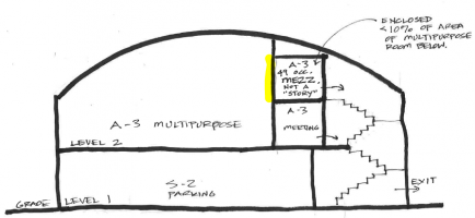

I too have an existing A-3 multipurpose building (church) that has a very tall A-3 multipurpose space at the second floor level.
The owner would like to add an A-3 fully enclosed mezzanine, but only has enough room for one stair, with <75' CPET.
Per CBC Table 1006.3, a story with only one exit access is not allowed at above the second level, so I really need this to qualify as a "second story mezzanine".
The yellow area below indicates the only wall face which "shares atmosphere" with the multipurpose room off to one side of it.
Question: is this single shared wall sufficient to have the 3rd level qualify as a second-story mezzanine?
Is this proposed mezzanine considered "within" the room below?
Keep in mind that the only opening on any wall of the mezzanine is the door that leads to the exit stairwell.

2022 CA-BC - 505.2.3 Openness
A mezzanine shall be open and unobstructed to the room in which such mezzanine is located except for walls not more than 42 inches (1067 mm) in height, columns and posts.
Exceptions:
  1. Mezzanines or portions thereof are not required to be open to the room in which the mezzanines are located, provided that the occupant load of the aggregate area of the enclosed space is not greater than 10.
  2. A mezzanine having two or more exits or access to exits is not required to be open to the room in which the mezzanine is located.
  3. Mezzanines or portions thereof are not required to be open to the room in which the mezzanines are located, provided that the aggregate floor area of the enclosed space is not greater than 10 percent of the mezzanine area.
  4. In industrial facilities, mezzanines used for control equipment are permitted to be glazed on all sides.
  5. In occupancies other than Groups H and I, which are no more than two stories above grade plane and equipped throughout with an automatic sprinkler system in accordance with Section 903.3.1.1, a mezzanine having two or more exits or access to exits shall not be required to be open to the room in which the mezzanine is located.
Looks like...
  • Exception #1 will not work; OL>10
  • Exception #2 will not work; single exit
  • Exception #3 will not work; whole room is enclosed and measurement of enclosed is 10% of the mezzanine area
  • Exception #4 will not work; not an industrial facility
  • Exception #5 will not work; single exit/exit access

Let me clarify: the aggregate floor area of the enclosed space of the 3rd level mezzanine is less than 10% of the floor area of the big multipurpose room on the 2nd level, so I think it qualifies for exception #3.
The things I'm not sure about are:
Does sharing one single wall (with no openings) with the floor below qualify it as "mezzanine"?
Note in the sketch that the footprint of the "mezz" space is not located directly over the footprint of the big multipurpose room. Does it still qualify as a mezzanine?
Exception #3 specifies that the enclosed space is limited to 10% of the mezzaanine area. Meaning that you could have a room on the mezzanine that is enclosed, not the mezzanine itself.
Example - If the mezzanine area is 1000sf, you could have a single room of 100sf that is enclosed.
