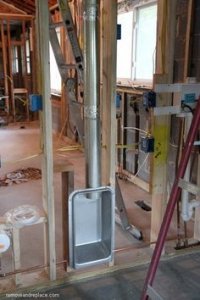

Depending on the jurisdiction we work in we see different interpretations of the IBC concerning the penetration of the dryer pipes from the laundry area to the exterior wall. Some jurisdictions are requiring dryer wrap and others are not. 2015 IMC 607.1.2 states that the penetration must comply with 2015 IBC 714.4 which deals with horizontal assemblies not required to be in a shaft. 714.4 states that the assemblies must comply with 714.4.1.1 through 714.4.1.4.. 714.4.1.1 deals with through penetrations and 714.4.1.2 deals with membrane penetrations. Both have a similar exception 1 which seems to indicate that all that is required is that the annular space must be protected. I don't believe that the remaining two sections apply in our case. I believe the dryer wrap requirement is based on 714.4.1.1.2 which requires a through penetration fire-stop system but doesn't exception 1 apply to a dryer pipe and negate that requirement?
So are you penetrating a rated wall???
Most I see all pipe is ran in the Interstitial space
If the pipe is already in a rated ceiling floor assembly and does not penetrate a rated wall
It should be good to go
You need to follow the installation instructions of installing an additional layer of drywall and packing the stud cavity full of fiberglass or mineral wool insulation depending on the box used

You would be running from a non rated void into a rated void assembly, but more than likely you are not going through any rated sheetrock ??? Would have to see where the rated meets the non rated
Yes just properly seal
Like this
Appears where the vertical meets the horizontal wall, should be rated ???
