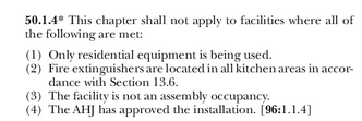

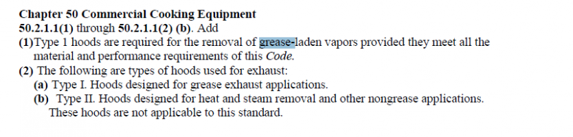

Since we are discussing a fire station therefore not a residence, it is commercial and if it has cooking that produces grease-laden vapors
NFPA1, with MA adendment, then to NFPAfor 96
