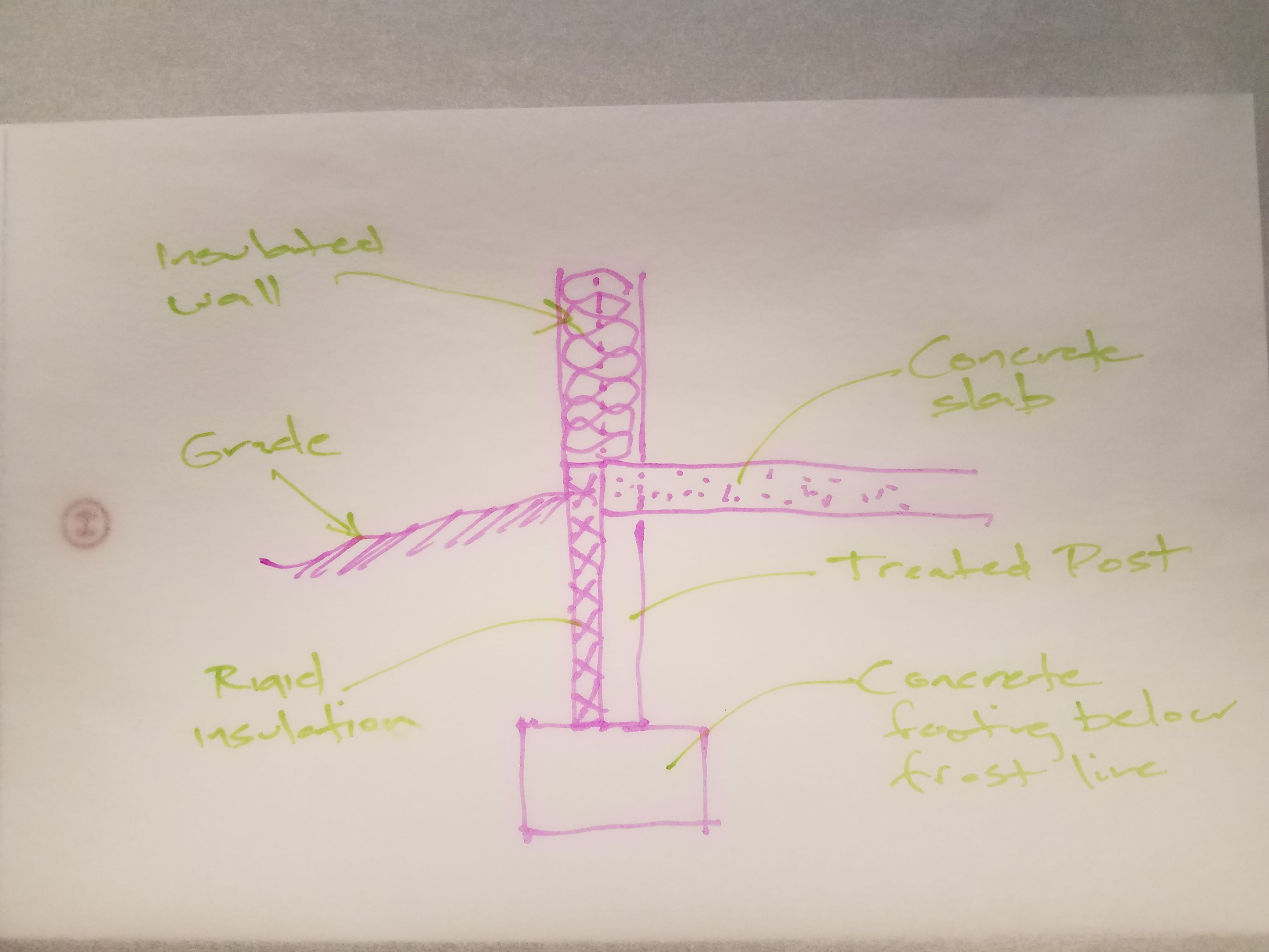

I know per section 1809.5 that the supporting structure needs to be below the frost line, but are there requirements, or minimum requirements for an insulated frost wall that would protect the building's slab from heaving?
Although it might hard to construct this in the field, as illustrated below, could you theoretically just put rigid insulation between the posts to protect the slab?

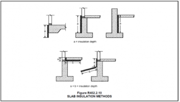

If the IECC is adopted, then the perimeter of the slab must be insulated to the depth indicated if in Climate Zones 4 through 8 for unheated slabs, and for all Climate Zones if the slab is heated (2015 IECC Table C402.1.3).
sounds good. So that "insulated wall" could be merely rigid insulation, if you could make it work in the field. Correct?
Or in other words, there's no structural requirement for that "insulated wall" if indeed, it's not structural.
If the posts are the only load-bearing elements, then the below-grade wall is there just to support the required insulation.

If it's an IECC project, insulate to the bottom of the slab and horizontal under the first 18" (6" slab + 18" under = 2', per Table 402.1.2) of the slab edge and be done . Any interpretation of the code that would ask you to dig a trench just to put insulation in for that type of structure is way wrong.
The image is in reference to the residential requirements of the IBC, but the same conditions also apply to the commercial requirements in IECC Section C402.2.5.

Logically, it seems like the soil below the slab in the following section could still heave and thus creak the slab.
Am I missing something? Not sure why this is an acceptable approach code-wise.

The soil under the slab is not exposed to freezing temperatures. The insulation at the perimeter is to prevent thermal bridging to the exterior.
