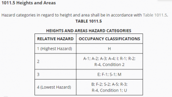

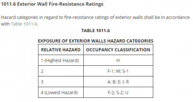

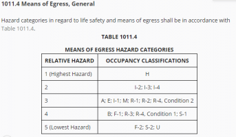

Is there a chapter or section that covers which occupancy type is a higher hazard than another occupancy type??
Thank you
What ClassicT posted are the only references in the IEBC, but these are specific to the indicated applications and are not intended as a means to generally classify occupancies by relative hazard. You can probably extrapolate a basic classification based on the information the tables provide, but it would not be something that could be used for enforcement.
